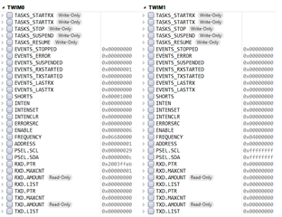

But when I run the application, the execution is stuck in this loop of nrfx_twim.c starting from line 441:
while (!nrf_twim_event_check(p_twim, evt_to_wait))
    if (nrf_twim_event_check(p_twim, NRF_TWIM_EVENT_ERROR))
        NRFX_LOG_DEBUG("TWIM: Event: %s.", EVT_TO_STR_TWIM(NRF_TWIM_EVENT_ERROR));
        nrf_twim_event_clear(p_twim, NRF_TWIM_EVENT_ERROR);
        nrf_twim_task_trigger(p_twim, NRF_TWIM_TASK_RESUME);
        nrf_twim_task_trigger(p_twim, NRF_TWIM_TASK_STOP);
        evt_to_wait = NRF_TWIM_EVENT_STOPPED;
Can you please tell me what I am doing wrong and what to do to make TWI work with PORT1 gpios ?
