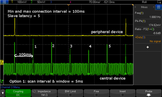

I think it's caused by switching the radio between tx (where central is sending massage to peripherials), and the rx (where central is scanning for advertising packets). Central can collect only 40-50% of all sent advertising packets by beacons. I made some tests with two options ( view current consumption on oscilloscope to visualise TX and RX state ):

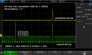

1) Scan interval and scan window = 5ms
We can see the peak where central device is sending the message to peripherial and the slave latency (5). The problem with collecting advertising is where the advertising is sent where central is not scannig (for example "?" area). Second problem is the switching time between RX channels.

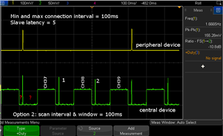

2) Scan interval and scan window = 100ms
What is the reason on this gap, marked with "?" ?
Few question:
1) In central device, when packed is sending to peryperial, Rx scanning is stopped in all scanning interval ( as we see on picture above for 5ms in first otion and 100ms for second option). Why scanning isn't immidietly started just aftrer Tx event.
2) How to maximilizeme scanning time witch two peryperial connected? How to set scan interval and window when connection interval is 100ms ?
3) Is there any mechanism to fix this problem? For example advertising with ack? (Beacon: if there is no ack, send adv once again?). I know that there is scan request mechanism - can I use it as "ack" mechanism? (Beacon: if there is no scan request, send adv once again).
    This is due to how the SoftDevice scheduler works. First of all, scanning always has lower priority than connection events. The scheduler will always schedule full events, so in order to make room for scanning between the connection events, you need to make the scan window shorter than the connection interval (but keep the scan interval and connection interval identical). This is explained in the SoftDevice specification:
    A primary channel scanner timing-event is always placed after the central link timing-events. Scanner timing - one or more connections as a Central shows that when there are one or more active connections, the scanner or observer role timing-event will be placed after the link timing-events. With scanInterval equal to the connectionInterval and a scanWindow ≤ (connectionInterval - (∑ tevent + tScanReserved)), scanning will proceed without overlapping with central link timing-events.
    As a practical example, you can take an unmodified BLE Blinky Application from SDK 15.3 and modify the sdk_config.h file of the BLE Multi-link Example as shown by this diff and observe the scanning duty cycle like you have done with your application. You will see that it scans for most of the time, which is because it is configured with a shorter scan window (and a shorter event length), so that scanWindow ≤ (connectionInterval - (∑ tevent + tScanReserved)) is respected.
    It is the same principle with two peripherals connected, but the scheduling becomes more complex, so you need to reduce the window length more, or use shorter windows and intervals as you have already attempted.
