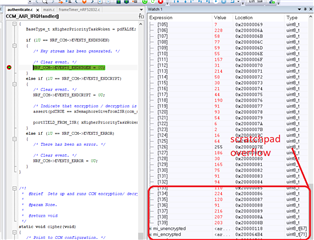

The scratchpad is overflowing when generating a keystream prior to a CCM decrypt operation.
The size of the scratchpad is calculated according to the formula in the product specification:
"A space of 43 bytes, or (16 + MAXPACKETSIZE) bytes, whatever is largest, must be reserved in RAM."
In this case we have a payload of 64 bytes which gives MAXPACKETSIZE = 64 + header + length + RFU + MIC = 64 + 1 + 1 + 1 + 4 = 71.
This gives a scratchpad size of 16 + 71 = 97
To illustrate the problem a scratchpad size of 140 has been chosen.
A decryption operation is attempted as follows:

As the code to shortcut the end of keystream generation to encryption/ decryption is commented out, only the keystream is generated. If a break point is put on the end of keystream event in the interrupt it can be seen that the scratchpad has overflowed.
Any ideas ?

    Since then I have solved the issue.
    The root of the problem was the amount of space allocated for the scratchpad.
    According to the CCM chapter of the product specification:
    As there is no definition of MAXPACKETSIZE to be found in the CCM chapter, I made an assumption.
    I took MAXPACKETSIZE  to mean the maximum packet size I intended to use which was:
    This turned out to be inadequate and caused scratchpad overflows.
    Trial and error showed that MAXPACKETSIZE actually means the maximum theoretical packet size. This gives:
    MAXPACKETSIZE  = 255 + header + length + RFU + MIC = 255 + 1 + 1 + 1 + 4 = 262
    Using this value of MAXPACKETSIZE to calculate the required scratchpad size results in no overflows.
    The requirements for the size of the scratch data area could perhaps be a little clearer in the product specification.
    Thanks.
    I am glad you found the issue., and thanks for letting me know the details. I have reported this internally so that the PS can be updated, properly defining MAXPACKETSIZE.
