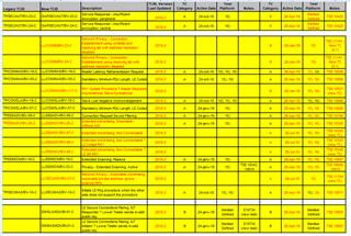

Hi Kaja,
we are doing BT SIG certification, The QDID of the S140 nRF52 link layer (122146) and 122684 (ATT/GAP/GATT/L2CAP/SM) are not up to date and require TRCL-2018-2
please see bellow the needed additional test to follow TCRL2018-2
