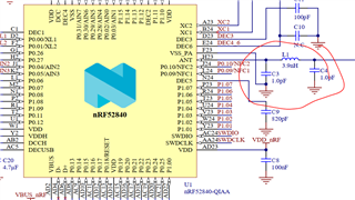

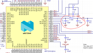

Conflicting recommendations for matching components
I'm using the nRF52840 in a new design, following the reference designs as a guide.  I've noticed that the reference layout files and the development kit use a different pi network for matching the RF port.  Is one preferred, or is this just something that must be tuned once boards are built.
Here are screenshots.
nrf52840_quiaa_var5.SchDoc:
PCA10056:
