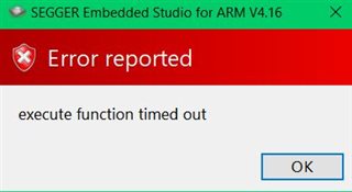

I am able to compile, load/flash successfully for my BLE + FreeRTOS application to my nRF52840 DK board. However, I am not able to start or pause execution of the application using Segger. Starting execution ('Go' in Debug Menu) doesn't seem to start / restart the application on the nRF52840. In addition, if I pause execution, the Segger Debugger interface will show that execution was paused within the application (i.e., the debugger stops at an actual function in the application) but then my debugger session ends (within about 1 second of me pausing the debugger) and I am shown the following error:
This appears within one second of me pausing the debugger.

  • I understand pausing a BLE example when the soft device's BLE is running will crash the example once the sample is resumed from pause. My issue is that I never get a chance to really review where I paused a function (and breakpoints are also not triggered as well). Whenever I pause the example, after a second the image in the original post pops up. Pause does not stay paused. Instead, the debugger crashes before I ever resume the example.
  • I found that an SPI peripheral component initialization code involving a while loop had been causing the application to halt on the same line every time. The initialization was being done outside of the FreeRTOS tasks I was using (i.e., I was initializing this SPI peripheral in the main() before vTaskStartScheduler() ). Once I put the SPI peripheral initialization code inside of that peripheral's corresponding FreeRTOS task, everything worked perfectly.
