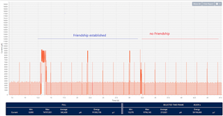

From my measurements it looks like the application is never entering low power mode, even though the poll timeout is set to 30 seconds.
You can see that the nRF module consumes more power for a short period of time to establish the friendship, but nothing is changing after that.
So my question is what might stop the application from entering low power mode and how to pause the application manually. (1)

    Still my problem remains. As you can see, the node still consumes a tiny bit more power in friendship node.
    How is this possible? Is it, because of the polling process?
    And in this case, wouldn't it be better to just use the low power node without a friend connection?

    The polling completes about every 8 seconds. Looking at the image before, this confirms my guess, that the two big peaks that can be seen once the friendship is established are due to the polling process.
    However, there still seems to be some other stuff going on there, which behaves consistent no matter if the device is in low power mode or not.
    For now I cannot really see the difference in the two, besides the added peaks from the polling process.
    Maybe the Mesh team can clarify what's going on here.

    The Mesh time provided the following feedback:
    The example was designed for demonstration purposes, and hence some of its features (namely, status LEDs and RTT input polling) cause a significant amount of power consumption when the example firmware is executing. For this reason, you must disable these features to obtain more accurate power measurements.
    Apply the following modifications at the paths provided:
    • \examples\experimental_lpn\include\nrf_mesh_config_app.h
      • Disable use of DK LEDs by setting SIMPLE_HAL_LEDS_ENABLED to 0.
      • Disable RTT Input by setting RTT_INPUT_ENABLED to 0.
    • app_mesh_core_event_cb() in \examples\experimental_lpn\src\main.c
      • Disable proxy service advertising when NRF_MESH_EVT_FRIENDSHIP_ESTABLISHED event is received by calling the proxy_stop() API.
      • Enable proxy service advertising when NRF_MESH_EVT_FRIENDSHIP_TERMINATED event is received by calling the proxy_enable() and then the proxy_start() APIs.
    After making these modifications, recompile the LPN example and flash this example and the Zephyr friend binary on two development boards. Provision the Zephyr Friend node into the network using nRF Mesh App.
    Please perform the suggested modifications and see if you see a reduction in the current consumption of the LPN node.
