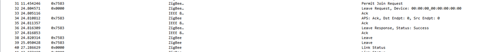

With sniffer, leave request message shown "Malformed Packet".
malformed.pcapng
in main.c in coordinator, i inserted my_leave function call when ZB_ZDO_SIGNAL_DEVICE_ANNCE is received.
and
in my_leave_function, i filled field req->dst_addr with the ZED short address
(req->dst_addr = 0x089b;)
Why the packet is Malformed ??

  • Hi.
    I have found the error. You should not call my_leave in ZB_ZDO_SIGNAL_DEVICE_ANNCE because of timings.
    I used this code for my_leave:
    static zb_uint16_t short_addr_global;
    void zboss_signal_handler(zb_uint8_t param)
        switch(sig)
           case ZB_ZDO_SIGNAL_DEVICE_ANNCE:
                    zb_zdo_signal_device_annce_params_t * dev_annce_params = ZB_ZDO_SIGNAL_GET_PARAMS(p_sg_p, zb_zdo_signal_device_annce_params_t);
                    short_addr_global = dev_annce_params->device_short_addr;
                    NRF_LOG_INFO("Device with a short address %hx commissionned", dev_annce_params->device_short_addr);
    void my_leave(zb_uint8_t param)
      if(param == 0)
        param = ZB_REF_FROM_BUF(ZB_GET_OUT_BUF());
      zb_buf_t *buf = ZB_BUF_FROM_REF(param);
      zb_zdo_mgmt_leave_param_t req;
      zb_uint8_t tsn;
      ZB_MEMSET(req.device_address, 0, sizeof(zb_ieee_addr_t));
      req.remove_children = ZB_FALSE;
      req.rejoin = ZB_FALSE;
      req.dst_addr = short_addr_global;
      ZB_BUF_REUSE(buf);
      ZB_SET_BUF_PARAM(buf, req, zb_zdo_mgmt_leave_param_t);
      tsn = zdo_mgmt_leave_req(param, leave_callback);
    And I called my_leave after a small delay.
    Please try this.
    Andreas
        switch(sig)
      if(param == 0)
      zb_uint8_t tsn;
      ZB_BUF_REUSE(buf);
    Please try this.
    Andreas
