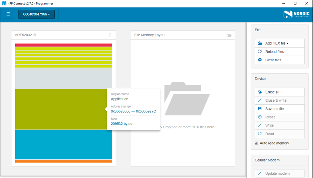

In the nRF52832 (Laird BL652 module) I have programmed.
MBR + SoftDevice from 0x0000 0000
Application from 0x0002 6000 ~ 0x0005 927C
Now trying to program additional application hex.

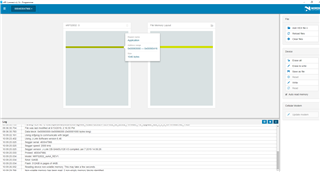

nRF Connect v2.6.2 - Programmer
17:50:15.426 Using nrfjprog to communicate with target
17:50:16.547 Using J-Link Software version 6.44
17:50:17.350 Segger serial: 683904660
17:50:17.350 Segger speed: 2000 kHz
17:50:17.350 Segger version: J-Link OB-SAM3U128-V2-NordicSemi compiled Jan 7 2019 14:07:15
17:50:17.351 Probed: 683904660.
17:50:17.351 Model: NRF52832_xxAA_REV2.
17:50:17.351 RAM: 64KiB.
17:50:17.351 Flash: 512KiB in pages of 4KiB.
17:50:18.424 Reading device non-volatile memory. This may take a few seconds.
17:50:25.985 Non-volatile memory has been read. 11 non-empty memory blocks identified.
17:50:26.403 SoftDevice detected, id 0xAF (S132 v6.1.0)
17:50:26.406 SoftDevice detected, id 0xAF (S132 v6.1.0)
Page 0x00065000 ~ 0x00065FFF => no content

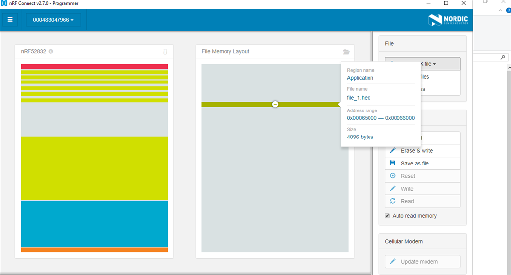

where, file_1.hex contains application in intel hex format:
:020000040006F4
:10500000FE9000030B020400000017002000493B43
so on
:105FF000FFFFFFFFFFFFFFFFFFFFFFFFFFFFFFFFB1
:00000001FF
Using nRF Go Studio 1.21.2,
....hex programmed successfully.
Verification failed.
And there is nothing in the page 0x00065000.
I don't see anything wrong here.
Do you?
Please let me know the solution.

    Opened using nRF Connect (desktop, v 2.7.0) Programmer (v 1.1.0)
    Nothing in page starting address 0x65000

    File layout is recognized properly with the address as expected
    And it does not overlap with other regions
    If I do  Erase & Write , it will erase whole chip.
    Write option is disabled !

    09:36:35.753	Parsing HEX file: C:\Users\... ...\file_1.hex
    09:36:35.754	File was last modified at 6/13/2019, 2:16:55 PM
    09:36:35.783	Data block: 0x00065000-0x00066000 (0x00001000 bytes long)

    Though file_1.hex is displayed in the File Memory Layout , it is not programmed ?
