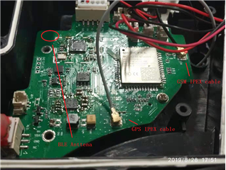

We are using the nRF52832 and 2G(GSM/GPRS) module to build up one IoT product. We got a disconnect between nRF52832 with other master instance(mobile phone APPs) when there is data sending/receiving with 2G tunnel(900M/1800M). The reason we  get printed (p_ble_evt->evt.gap_evt.params.disconnected.reason) is 0x08(connection timeout).
Our board is look likes as this:
We suspect the EMI/EMC for disconnection reasons,  if we move the 2G cable to opposite direction(far from 2.4G BLE PCB antenna), there are no disconnection issues.

    The GSM module is probably blocking the nRF52832 reception. Even though they are quite distant in frequency, the signal power from the GSM module is high enough that it will block the nRF52832 receiver.

    We have tried several method with hardware change to get it solved in the past month, but found no improvements .
    1. Place magnetic bead on the power path of nRF52832, isolate it with other blocks
    2. Add 2.4G filter/SAW on the RF input of nRF52832
    3. Seperate away nRF52832 + ANT with the GSM+IPEX cable
    Since the PCB board is installed in a plastic box which placed in a metal shell of smartlock, and GSM radio may be reflected in the sealed-off space.  So, if there any other further solution?

    Is it not an option to direct the cable away from the nRF52832 when the device is mounted in the enclosure? I also notice you have solder pads for a shield can around nRF52832, does adding this help?
    You can try to use the PA/LNA optional interface to toggle a GPIO when the nRF52832 Radio has a RX event, if your GSM module supports it that could keep it from transmitting when the nRF52832 is in RX.
    There is no way to decrease sensitivity of nRF52832 to avoid the blocking except filtering externally, which you said did not help.
    Have you monitored the supply line or if the nRF52832 resets when the GSM module turns on? If the supply can't keep up, causing a >300mV step, the nRF52832 might reset.

    1. Now we direct the cable away as far as possible, but didn't change the result.
        We are trying to  add the  metal shield shell , and haven't  get result now.
