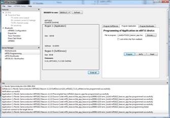

  1. Download the nFRgo studio to download the hex file with the jlink.
image description

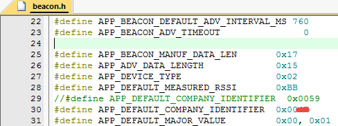

  1. Modify the beacon example from the nRF51822 Beacon v1.1.0. I modified the beacon.h in C:\Nordic Semiconductor\nRF51822 Beacon v1.1.0\Source Code\nrf51_beacon\common\beacon directory line 29
From: #define APP_DEFAULT_COMPANY_IDENTIFIER 0x0059 To: 0x0059 -> 0x00?? (The Apple ID).
image description
No error in compliation, get the hex file, no error in downloading the hex file into the nRF51822 beaon.
Reset the device after the programming, and scan to register the device.
  • Yes that's the right source, as I said in the other thread. Yes the fields are correct, you just need to change the manufacturer id, the UUID, the major/minor and the RSSI (if you want to change that, I left it alone).
    The first 3 bytes are the advertising flags which are set in the code and sent out at the start of the packet, the 5th byte is just a flag for manufacturer-specific data which the softdevice will add because you set the p_manuf_specific_data field of the ble_advdata_t and it will calculate and add in the total length as well which is the 4th byte.
    The apple document points you to the core BTLE spec, Volume 3, Appendix C section 18.1 which explains the first 7 bytes in the packet. That leaves 23 bytes (0x17) so everything is fine.
    Yes it's confusing that one document says 0x0215 is the beacon id and the code splits that up into two pieces 0x02 for an ID and 0x15 which is the remaining length of the data, the net effect however is the same (and it is actually 0x02 + length as far as I'm aware).
