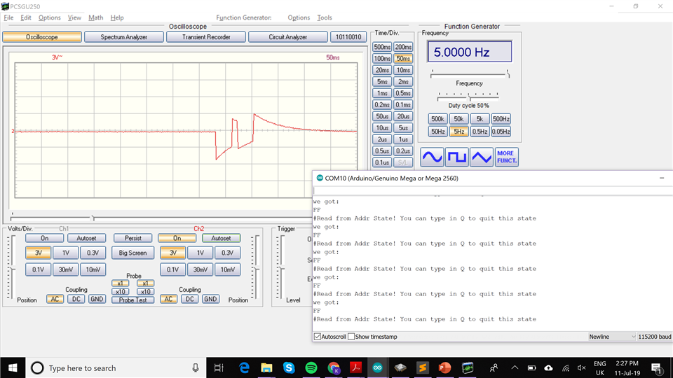

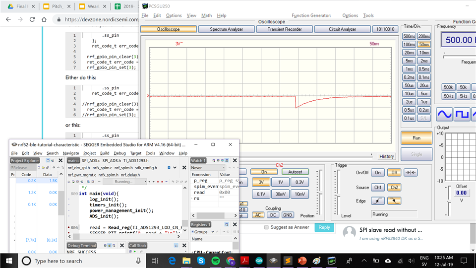

  • Thanks! I removed the manual ss controls and lowered the speed. Now I get this on the oscilloscope although the execution still gets stuck in the same place:
    Here is what it looks like on the Arduino that works:
  • You have the 'scope incorrectly set to the AC setting on both probes; change to DC ..for the slower clock speed also slow down the timebase to see the whole waveform. 50mSecs seems already very slow, what speed are the SPI clocks?
    The Arduino is doing 2 separate SPI transactions of 1 byte each; you can do the same on the nRF by sending 2 messages of 1 byte each; the first would be the command and the second would clock out the response. Inefficient, but then you compare like with like and can increase the clock back to the same as Arduino.
  • Thanks again! I changed to DC and now I see that everything is the same for the Arduino and Nordic chip except for the SDO on the slave chip, nothing gets sent back from the ads for some reason when using the Nordic chip.
