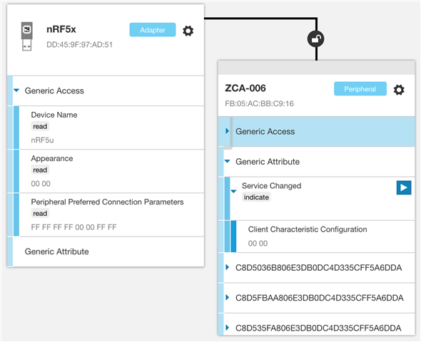

We're using the nRF52832 as a peripheral and server. A central and client (tablet) connects to the nRF52832.
Yesterday I noticed that sometimes the tablet will try to perform a write to handle 0x0D, which I figured out was the Client Characteristic Configuration, which lies under Generic Attribute -> Service Changed.
The value it was trying to write was 0x0200, which, if I'm not mistaken, is to enable notifications.

    1: The value 0x0200 is actually indications, and not notifications. It is similiar to notifications, but with some slightly different properties. Nothing you need to worry about in this characteristic.  The characteristic that the tablet enables indications is the service changed characteristic. This doesn't surprise me, since this service is used to let the connected device know whenever new services or characteristics are added, so that the central can do a new service discovery. You don't need to handle this actively.
    2: As I said, I believe this is the OS on the tablet that wants to enable indications on the service changed characteristic so that it knows when it has to do a new service discovery, and when it is unnecessary.

    If you are doing development on a DK, tablets and phones tend to store some information regarding devices. So if you flashed another example that didn't have the service changed characteristic, the tablet may think it already know all the services and characteristics, and there is no service changed characteristic to tell it otherwise. Obviously, it is, but the tablet is not aware of it, because it has cached the already known services, and seeing that it is the same device (same address), it will not do a service discovery every time it connects unless it is aware of a service changed characteristic that is telling it that it has some new services.
    The service changed characteristic is handled by the softdevice, so it is typically not something you need to take care of, other than including it in your project if you want to use it.
