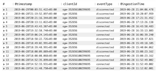

However we are experiencing some trouble where after (usually) an extended period of many hours whereby the nRF9160 seems to think it's connected to AWS, whereas by looking at the logs we have created on AWS we know that the nRF9160 is most certainly disconnected.
This constitutes a complete failure of our system.
