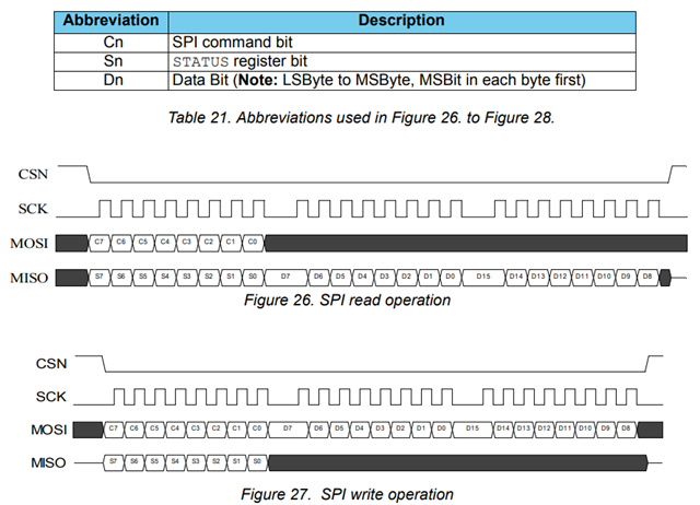

    SPI read or write typically always is minimum 2bytes: First byte is the command byte that indicate the register address to access (read or write), second byte (or several bytes) contain the data (value) of that register.
    So to answer your questions:
    1. The first temp = HAL_NRF_HW_SPI_READ(); is basically a dummy read, but to save RAM the same variable 'temp' is updated two times (used as dummy first time, then actual value to read 'temp' the second time).
    2. When writing the first byte to indicate the register address to access, then the return dummy byte actually contains a STATUS register that can be used.
    As an example of SPI transfer see below sequence when read or write to the Radio (nRF24L01).
    Kenneth

    To create an SPI clock, you will need to write some data on the SPI, the data can be a command, a value, or dummy. SPI is always bidirectional, so for each byte written, there is one byte received. Whether you want to keep any or all of the values received depends on the command.
    Kenneth

  • You will need to call 'input' = HAL_NRF_HW_SPI_WRITE('output') every time you want to clock the next 8bit on the SPI interface, at the same time you then transmit 'output' and receive 'input'. If the output or input is don't care, you use can use any value (e.g. 0 or dummy value).
    Kenneth
