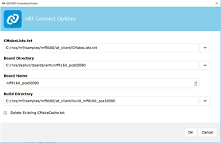

Hello, I was finally able to connect the board via LTE to my nRFCloud account. However, when I go through the getting started guide, specifically the programming a sample program, I am gettin stuck on actually building the project.

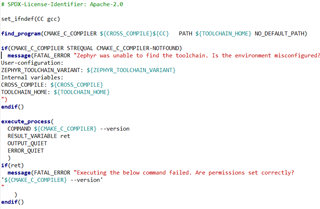

as soon as I hit "OK" it spits out this error
Here are my environment options
I've been bashing my brain against this problem for about two days now, so any help would be appreciated. Thank you

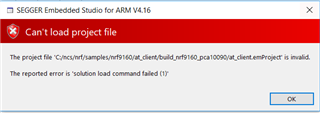

    I am however having trouble flashing it to the nRF9160 device through the SES program.
    I can't select the build and debug option, despite having the board connected and powered on.
    Also when I try to connect J-Link it gives me the error
    I do have the latest version of JLink
    So I'm a bit lost.
    It did seem to build the merged hex file, so I'll try and flash that over using the nRF Connect programmer or I could just drag and drop the hex file over, but I was wondering if you think I'm doing something wrong as to why I can't program from SES.
