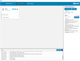

Upon using nRF Connect (either PC or mobile versions), the correct device name is displayed:
This end of device name string corruption does not just happen for this particular device - I have tested scanning other devices where I see a similar behaviour with differing amounts of corruption (e.g. some devices only have 1 character that is corrupted at the end of the string). However, not all of the devices I have scanned display the corruption; some devices have their advertising names being received correctly.
