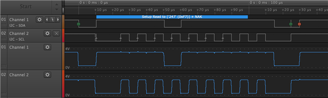

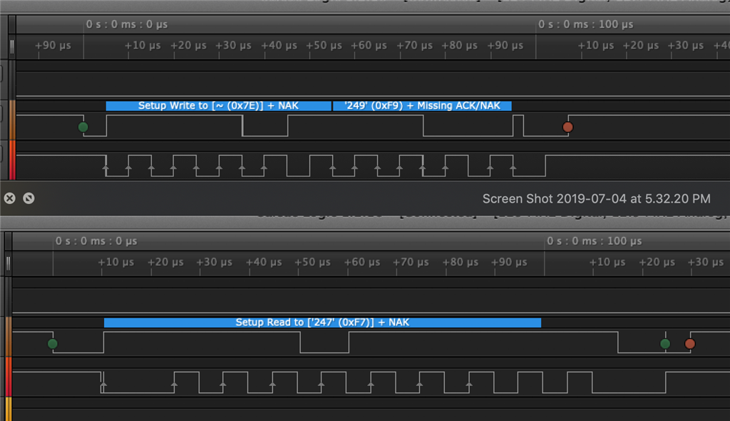

I compared the Arduino (top) and nRF52840 (bottom) communication and was surprised to see that the clock for the nrf5 was a bit odd, any additional tests that could be done to get the MS5611 working?
Any suggestions much appreciated!
Logic Analyzer
  • Below the full view of the nRF52840 communication including analog signal. And yes, there are 4.7k pull ups on the board.

    Thanks for sharing the analog plot. Based on that it doesn't appear to be a signaling problem, the sensor simply doesn't ack the command for some reason.
    Have you made sure that the CSB pin is the same in both cases, to satisfy the requirement from the sensor datasheet that the MS5611-01BA address is 111011Cx, where C is the complementary value of the pin CSB?
    The working example based on the Adafruit Trinket is issuing a write command, while the non working example with the nRF52840 is issuing a read command. Can you try a write command on the the nRF52840 also and see if it still doesn't work?
