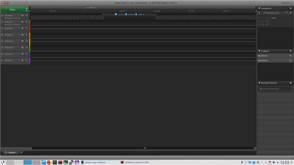

In our project there is a problem that we encountered is happening when the Nordic BLE mesh advertising and connectable advertising for GATT connections are enabled in the same time. This problem is behaving by blocking the access to CPU for maximum of 15.3 ms, which is huge. As you can see in the attached images, these blocking issues are sporadic without having a period of happening. This is not happening if there only Nordic Mesh is available or only the GATT advertising is started. We are thinking of using the Radio timeslots but we suppose this will resolve only the transmission part since the reception is asynchronous from a third party device.
      We are using the TIMER1 interrupt for toggling an GPIO (in project it used to have the clock on the line). The Softdevice used is S140 6.1.0 and nRF5 SDK v.15.0
   How can we handle this worst 15.3ms latency? Who needs so much CPU time?

    It seems high with 15.3ms. I'm not sure what is causing this, but you can start by debugging the code and see where it hangs?

  • Hi Martin,
       The blocking interval and the TIMESLOT_REQ_EARLIEST_TIMEOUT_US (mesh-SDK/mesh/core/src/timeslot.c) definition (15ms) are in directed connection. Setting the TIMESLOT_REQ_EARLIEST_TIMEOUT_US to a different value the blocking interval goes to that defined value.
      Can you give me some hints regarding of what is happening in this timeslot and why the mesh without the gatt advertising does not get this blocking CPU period?
     Our custom advertising is connectable and it has

    How are you using both Mesh and connectable advertising for GATT connections at the same time? Are you using the timeslot API?
    If TIMESLOT_REQ_EARLIEST_TIMEOUT_US matches the blocked interval, I suspect that the request of the earliest timeslot isn't handled somewhere in your application. Can you see if this is the case?
    Also which Mesh example are you running?

  • Hi Martin,
       I have tried a few advertising connectable solutions, even the one from the proxy. In the attachment you can see the lastest inspired from the coexist examples available in NRF Mesh SDK 2.1.1,

    Have you had any progress with the issue?
    How do you check that the CPU is blocked?
