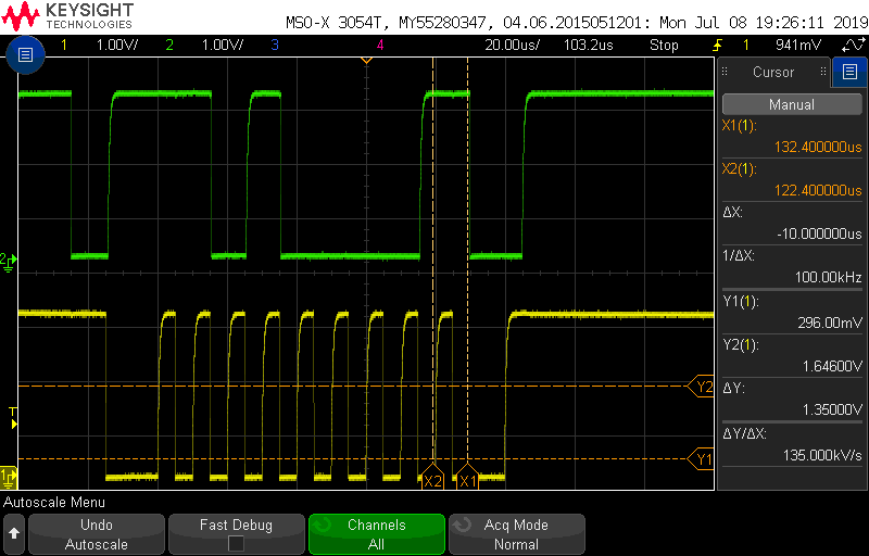

I started off to test all the drivers before the actual development process kickstarts.I tried using the TWI sensor example for an i2c driver check.I used a DS1307 simple RTC for it.But i am unable to even send my first data frame and here is my code.when I tried debugging the code ,it seems to be stuck in the while loop for completion check of  first tx transmission .
Can you point out my mistakes and any other suggestion i need to check .
Here are the complete specs
Board Rigardo BMD 350
SDK v15.3.0
DS1307 connection with Rigardo board
SCL PIN-->pin0.27
SDA PIN-->pin0.26
GND      -->GND
VCC (not connected using coin cell battery for power )
Rigardo board is powered by USB wire
Thanks in advance
