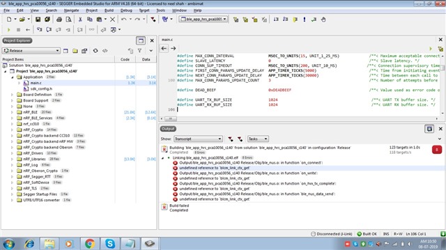

We are trying to include the UART.h into examples\ble_peripheral\ble_app_hrs and are facing the said error even after including the file.
Can you please help with resolving this error?

That error is about linkage, not compilation. Did you include the .c as well? Did you modify the sdk_config.h accordingly?

Within SES, on the project item: right mouse button and click "Add existing item". Add libraries/uart/app_uart.c. In the config file. Set the APP_UART_ENABLED to 1

We were able to resolve all the errors mentioned earlier but now in the code we are facing these errors. Can you please advice on how to resolve these?
That function is located in components/ble/ble_link_ctx_manager_ble_link_ctx_manager.c. Add this file as well.
