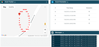

The asset tracker program still seems to be working as it's spitting out the dummy data and registering the FLIP state.
But I can't seem to get anything on the LTE Link Monitor.
    At least you have confirmed that your device is able to connect the LTE-M network

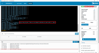

    <err>net_if.net_if_init: There is no network
    Where do you get this error?
    My SIM card is registered to my account, and it's obviously active as it's transmitting. I have the latest firmware on the device.
    How do you know you have the latest FW? Have you updated to the latest modem FW?
