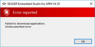

    We have modified the project to work on nb-iot  but when we try to flash the DK we get and error.
    To download we are using SES>Target>Download Zephyr/merged.hex
    Are we doing something wrong?
    Thanks Ian
  • Have you tried using Build --> Build & Run in SES v4.18? For SES v4.16 we had a work-around to support flashing a multi-image project (SPM + APP). This should be fixed in v4.18.
    That said, you should not get the error you get when manually downloading the .hex file. I will report this internally.
    Øyvind
