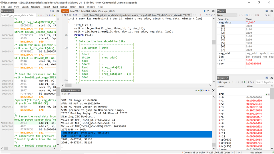

I am trying to read temperature, pressure, and humidity data from an Adafruit BME280 sensor using the nRF9160 DK.  The communication protocol that I am using is I2C and I am reading the data with the Zephyr RTOS function i2c_burst_read().  The problem that I am running into is that the only data that is being transferred is the first bit in the first byte of each measurement.  The screenshot shows the lines of code that I am using to implement the I2C data transfer and the output of the data transfer.  On the top right, in the watch window, the variable reg_data is where the transferred data is supposed to go and it can be seen that the value is 0x80080080.  Is there any idea what could possibly be going wrong?

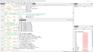

    When I built, I got an error on line 385 of the bme280.c file stating that DT_BOSCH_BME280_0_LABEL is undeclared and asked if it meant DT_BOSCH_BME280_0, so I changed it to that.  After, I was able to build without errors.  I attempted to run the program, but the following screenshot shows what happens.

    The sample should run without any modifications, but the sensor must be connected and the details in the overlay and configuration file must be correct. Please make sure that the pins and address in the overlay file is correct (the I2C slave address is listed both after the "@" in the node name and in the "reg" field).
    If your application is running in non-secure mode the I2C must be set up to be used in non-secure mode. You can either try to build the application for the nrf9160_pca10090 (not ns) board to run the application in secure mode, or you must make sure that the I2C/TWIM peripheral is configured correctly. From your output it looks like TWIM2 is configured for non-secure use, so you could try to change i2c3 to i2c2 in the overlay file and CONFIG_I2C_3 to CONFIG_I2C_2 in the configuration file.
    Didrik
  • Thank you.  I changed everything to i2c_2 and it worked.
