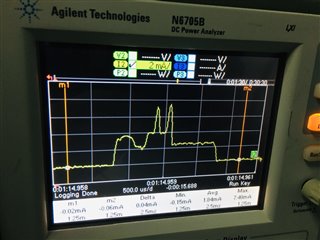

The NRF52810, gives the 0dBm out, with 4.6mA peak current。
When we using, we plan 20Kpcs for mass product, the current is more 4.6mA, it is 7.4mA。
we use the 2MBPS air datarate at frequency 2473MHz, with low energy, (link with NRF24L01), DC/DC, power is 3.0Vdc.
How can we do it to reduce the current to 4.6mA with 0dbm?

 3.0V 0dbm peak3.0V 0dbm detail

  • It's work as, sleep about 2.5S with 32.768Khz xtal, the current is about 1.5uA--2.0uA, the LF xtal is Epson fc_12M, load is 12.5pF.
    The 32M XT is Epson too, TSX-3225, load is 12pF. After sleep, then work with 32MHz Xtal.
    The 0dBm out, 3.0V, NOT use the BLE model.
    The Website is give the BLE current.is it include the MCU working current?
    we use NRF model. the software is done by another people.
    The Antenna matched, the S11  <-10db.
    The T5 is test for Ant output by network analyze(remove match part),and debug it,  then test PIF antenna, at lest design the match part, and test it,(Remove the L4),test antenna match in T5. The network and RF cable is calibrated too.
