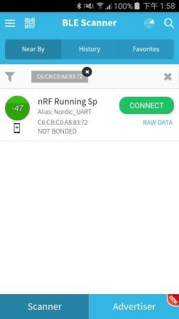

I want to use extended advertising features , I search ble_peripheral only one example is ble_app_rscs
I compiler and program, i can't find the device in my phone app
when I mark main.c > advertising_init() > init.config.ble_adv_extended_enabled = true;

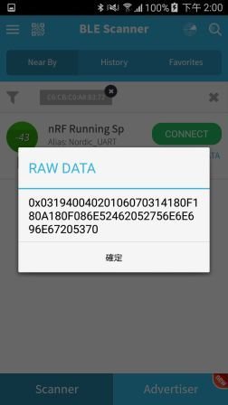

i find the device in my phone app, adv data is 31 bytes
my sdk is nRF_SDK_15.3.0, softdevice is s132nrf611
