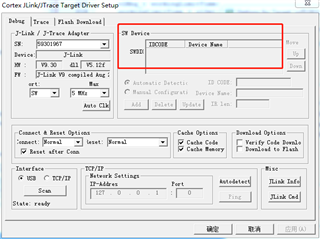

it occurs during mass production, The proportion is 1%,so it is hard to reappear ; writing SN by using barcode gun to scan two-bar codes on the device.
Do you use a programmer to set the SN in production, or is it written to flash by your application code? Also, on the failing unit, try to read out the whole flash page starting at 0x68000 and check if all bits are '1' or if some are set to '0'. The page is likely overwritten by application code if some are zero.
Reading flash with nrfjprog
nrfjprog --memrd 0x68000 --n 4096
SN is written to flash by application code; When SN is correct, data in page is correct,too; some of nrf52832 cann't be read because JLink don't know nrf52832, why?
Could you try to update your Jlink driver? v.5.12f is quite old, they are currently on version 6.46k: https://www.segger.com/downloads/jlink/#J-LinkSoftwareAndDocumentationPack
