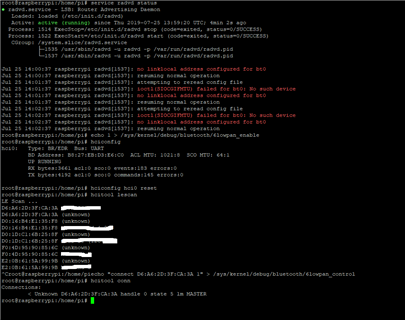

All commands were working fine until echo "connect <mac address of other device> 1" > /sys/kernel/debug/bluetooth/6lowpan_control. As seen from the websites, after this command execution, there should be bt0 interface created. But it is not visible in ifconfig -a.
Also the 6lowpan_control file is empty. But when I try to connect the other device using the command hcitool con after executing above command, I am able to see the desired connections in the terminal, still no bt0 device available. I have even tried with the command ifconfig bt0 add 2001:db8::1/64 but resulted with the error SIOGIFINDEX: No such device.
How to resolve this problem?
Note: I think I am facing this same issue.
  • Yes I made sure. Output of commands attached below. The radvd.service status throws error after I added the lines in radvd.conf as suggested in this link.
    I just have a doubt. As Rpi3 have a built-in Bluetooth module, I did not use any external Bluetooth LE USB dongles. I assume Rpi3 has in-built functionality of Bluetooth dongles. Am I wrong or is it fine to use built-in Bluetooth module?
