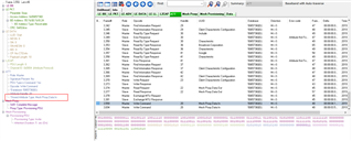

It always use proxy data in instead of provision data in when do provosioning process with other mesh devices by nRF MESH application
When I test nRF MESH application on android phone with other mesh device, after discover services, it always use proxy data in to write data to device for provisioning, after that, device will report the error messages as the attribute type is not right. supported to be provisioning data in, not proxy data in.
Does it refer to GATT database issue, something I missed in it?
