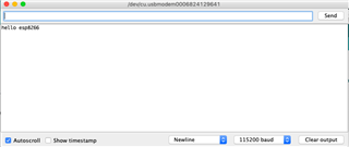

I want to send static data from nrf52 to esp8266. I have used serial Program from examples. I am able to send data dynamically from the serial monitor.
  • I want to send static data from nrf52 to esp8266.
    I don't understand what you mean by that!
    What have you tried?
    Where are you stuck?

    This is my code i am able to send the data from nrf52 dk to esp8266 through the serial monitor
    In the above image I sent a string from nrf52 to esp8266 through the serial monitor .
    I want to declare a static string and keep on sending it to esp8266.

  • So it's not static data, then - is it?
    But you have the code right here:
        ret = nrf_serial_write( &serial_uart,
                                tx_message,
                                strlen(tx_message),
                                NULL,
                                NRF_SERIAL_MAX_TIMEOUT) ;
        APP_ERROR_CHECK(ret);
    The nrf_serial_write() function just sends data - it neither knows nor cares where that data comes from, nor whether it is "static" or not.
    You just give it a pointer to (the start of) the data you want to send, and tell it the length of that data.
    Simples!
  •     static char tx_message[] = "Hello nrf_serial!\n\r";
        static char k[] = "jio";
        ret = nrf_serial_write(&serial_uart,
                               k,
                               strlen(k),
                               NULL,
                               NRF_SERIAL_MAX_TIMEOUT);
    No this part is not working I tried
  • So what debugging have you done to find why it works with 'tx_message', but not with 'k' ?
    Are you sure that your terminal doesn't depend on there being  a CR and/or LF on the end?
  • It worked now actually i kept a delay and executed the code
