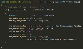

    You should check the return values of your softdevice function calls, such as sd_ble_gatts_hvx();
    I suggest that you change the function from void ble_central_adv_information_update() to uint32_t ble_central_adv_information_update(), and return the value from last function call:
    void ble_central_adv_information_update(ble_mpu_c_t *p_mpu, uint8_t* knee_angle)
        if(p_mpu->conn_handle != BLE_CONN_HANDLE_INVALID)
            ... // All the things that you already had
            hvx_params.p_data = (uint8_t*)knww_angle;
            return sd_ble_gatts_hvx(p_mpu->conn_handle, &hvx_params);
        else // p_mpu->conn_handle == BLE_CONN_HANDLE_INVALID
            return NRF_ERROR_INVALID_STATE;

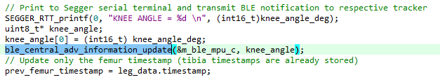

    and then check the return value from your function:
    uint32_t err_code;
    knee_angle[0] = (int16_t) knee_angle_deg;
    err_code = ble_central_adv_information_update(&m_ble_mpu_c, knee_angle);
    if (err_code != NRF_ERROR_INVALIDE_STATE)
    This way it is easier to check what the application is doing. What is the return value from ble_central_adv_information_update(&m_ble_mpu_c, knee_angle);

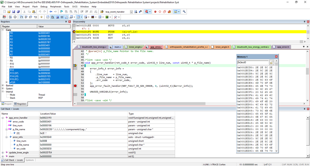

    I have adjusted the code to how you have suggested. These are the values of the error code, line number and file names in the error_info_t after the application stopped at the breakpoint in app_error_handler.
    The error code has value 0x3401 or 13313 decimal.

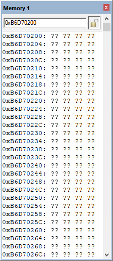

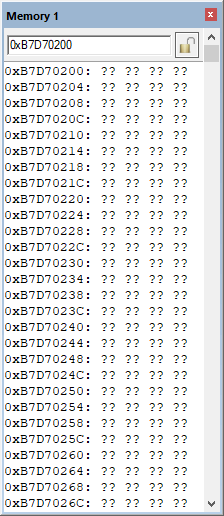

  • ok. Closing in. Can you hover over the p_file_name, and see if you can find the name of the file that it is pointing to. Alternatively, copy the memory 1 values that you have in your screenshot, and see the path (if you convert them to ascii/char values. It is somewhere in components\Leg<something-something>. Should be a .c file.
    If you remove the first breakpoint and add the second, it should update the error_info variable, but you can see that the line number "line_num" that is passed onto this function is 0x196 = decimal: 406. So in one of the files in the path components\Leg... there is a APP_ERROR_CHECK(err_code) on line 406. This one receives an err_code != 0. What is the function that returned this err_code?
    EDIT:
    I checked your path, but I believe you can see it if you hover over the mouse. In case not:
    So your file knee_angle.c has an APP_ERROR_CHECK(err_code); on line 406. What function returned this value? If it is not a direct softdevice call, what function inside this function returned this return value?
    Edvin
    Yes there is definitely an APP_ERROR_CHECK(err_code) function call in line 406 in knee_angle.c. Removing the first breakpoint and adding the second breakpoint (where the second breakpoint is on line 54 of app_error.c) returns the same error information in the error_info_t structure as in my previous post.
    The err_code in this context is not directly returned by a SoftDevice call, it is returned by ble_central_adv_information_update(...). The definition of ble_central_adv_information_update(...) is defined exactly as you recommended in your response on the 12th August.
    The err_code variable is being returned from sd_ble_gatts_hvx(...), which is called within ble_central_adv_information_update(...). The value of the error code is 13313 decimal or 0x3401, which is the same error code as my last post (essentially, it's the same error that's occurring). This sd_ble_gatts_hvx(...) call is performing a notification, where the knee angle is being transmitted to a remote mobile phone.
  • Ok, so sd_ble_gatts_hvx() returns BLE_ERROR_GATTS_SYS_ATTR_MISSING.
