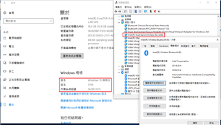

The window version of T470 was as bellowing

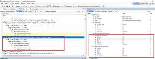

We had record the log by Ellisys sniffer
52832 nRF5_mouse with T470.btt
