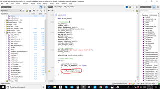

  • Amanda ,
          In "ble_app_hids_mouse"  i didn't find the functions calling for configure to use the power management module.
    1. "power_management_init()" is not used  in "ble_app_hids_mouse"
    2. And also not used  this"nrf_pwr_mgmt_run();" in "ble_app_hids_mouse".Then how you conform that all the power management module is configured in "ble_app_hids_mouse".

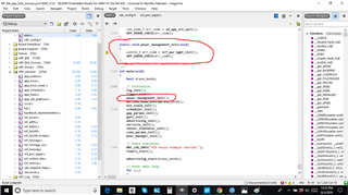

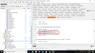

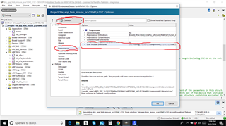

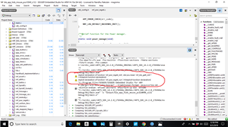

  • hi Amanda,
     I added all requested changes to add the buttonless dfu service to "ble_app_hids_mouse".
    But my code was execution was breaking ,when entering to the below function in services_init()
    • nrf_dfu_set_adv_name_init();  inside ble_dfu_buttonless_async_svci_init(void).
    please help me to solve these issue,

  • Actually there is no error is showing  .I just flashed the modified "ble_app_hids_mouse" which support buttonless dfu to the our board but its not advertising . so i debugged it using JLink then i noticed that when code execution is entering to " "nrf_dfu_set_adv_name_init();" but its not leaving from these function .
    i don't known why .
    note:- i didn't flashed the bootloader hex to our board.
