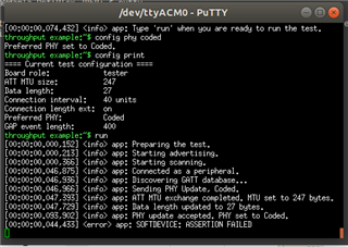

Hi everyone,
I'm trying to establish throughput test using mtu_throughput example(central-peripheral) and 2 nrf52840's but I keep getting error when set phy to coded. Here is the putty screen. PS I did try to learn what is wrong via debug but when I started to debug when test establishing, got error, made research about it and it says it happens when you use debug while you were testing. So my question is I'm using SDK15.3.0 and it says it's compatable with coded phy but why am I keep getting error? And why it's connecting as peripheral when in tester mode?
