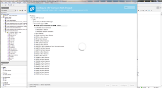

I tried to change Zephyr's partitions, you can find all the necessary information in the attached files.
As far as I understood, all libraries which are required for mdedTLS should be called from the security region only. In this case they will be located into the mcuboot partition, that's why I also increased size reserved for spm. It was done using the "spm_menuconfig" option in the menuconfig (Project -> Configure nRF SDK Project). I've found "Modules -> Nordic nRF Connect -> SPM -> Current app is SPM - > Flash space reserved for SPM" parameter and changed it's value from 0xc000 (48Kb) to to 0x1CCCC (115Kb).
Unfortunately, it led me to the following error:

    The linker issue is due to a too small partition size. That is also the case for the second issue, so you should expand that further since the SPU regions are 32 kB.
    The reason is that the SPM and application must be placed in different SPU regions (of 32 kB size) because one is secure and the other is non-secure. So the second error you get is because the region is large enough to fit the code, but you need additional empty space to place the app in a new region.
    Note that there is an issue with RSA in the current nrf_cc310_mbedcrypto library that you will likely meet. This will be fixed in the next release, which I expect will be out quite soon.
  • Do you mean that there are two regions: secure and non-secure (32Kb each) and secure region is big enough, while non-secure is too small and should be increased?
    Could you clarify where I can change this?
    Thanks in advance.
    You should increase the size of the flash space reserve for SPM so that it ends at the end of a 32 kB region. So setting it to 0x8000 should work.
  • Hi.
    I aligned now all partitions by 32Kb.
    And tried compile SPM with RSA mbed TLS function.
    Same error. I tried with SPM reserved size 0x8000, 0x19000, and 0x20000.
    Do you have any ideas how we solve this problem?

    New partitions sizes I added to attached files.Also I added my spm and secure_service sample project files and all build directories.
    nrf9160_pca10090_32Kb_aligned.zip
    spm_folder_from_subsys_folder.zip
    nrf9160_sample_folder_spm_reserved_size_0x8000.zipnrf9160_sample_folder_spm_reserved_size_0x19000.zip
