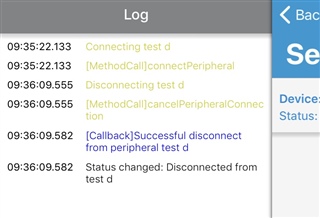

    The connection doesn't fail but it appearing to be connecting for a long time but it never gets connected. This is the log after I cancel the connection manually.
    Do you get the BLE_GAP_EVT_CONNECTED event, and how do you handle ble connection events in the ble handler? A sniffer trace of the connection would clarify what really happens. Could you take a nrf sniffer trace of the connection and upload it here?
