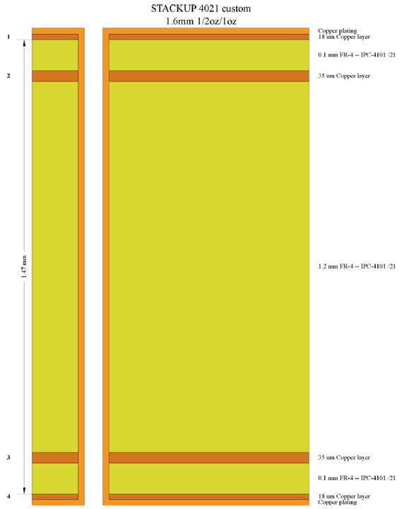

Dear Team,
in Feb 2019 this link was available: https://www.nordicsemi.com/DocLib/Content/Product_Spec/nRF9160/latest/ref_circuitry?932#concept_myt_5zt_bgb
with the recommended pcb 4layers stackup, somehow it is not available. Could you please share the new link?
Is there a new recommendation available, or the current is ok?
Thank you & Best regards
