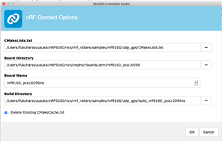

  • Hi, Martin. I followed your instruction, but I got this error. Could you give me any advice?
    Loading solution udp_gps.emProject
    Executing load commands
    /usr/local/bin/cmake -GNinja -DBOARD=nrf9160_pca10090ns -DBOARD_DIR=/Users/fukuharayuusuke/nRF9160/ncs/zephyr/boards/arm/nrf9160_pca10090 -DZEPHYR_TOOLCHAIN_VARIANT=gnuarmemb -DGNUARMEMB_TOOLCHAIN_PATH=/opt/gnuarmemb -B/Users/fukuharayuusuke/nRF9160/ncs/nrf_rallare/samples/nrf9160/udp_gps/build_nrf9160_pca10090ns -H/Users/fukuharayuusuke/nRF9160/ncs/nrf_rallare/samples/nrf9160/udp_gps -DPYTHON_EXECUTABLE=/usr/local/bin/python3 -DCMAKE_MAKE_PROGRAM=/usr/local/bin/ninja -DDTC=/usr/local/bin/dtc -D WEST=~/.local/bin/west -DEXTRA_KCONFIG_TARGETS=menuconfig_ses -DEXTRA_KCONFIG_TARGET_COMMAND_FOR_menuconfig_ses=/Applications/arm_segger_embedded_studio_v416_macos_x64_nordic/html/configure_nordic_project_menuconfig.py
    -- Using application from '/Users/fukuharayuusuke/nRF9160/ncs/nrf_rallare/samples/nrf9160/udp_gps'
    Zephyr version: 1.14.99
    -- Found PythonInterp: /usr/local/bin/python3 (found suitable version "3.7.3", minimum required is "3.4")
    -- Selected BOARD nrf9160_pca10090ns
    -- Found west: /Users/fukuharayuusuke/.local/bin/west (found suitable version "0.6.0", minimum required is "0.5.6")
    -- Cache files will be written to: /Users/fukuharayuusuke/Library/Caches/zephyr
    -- Loading /Users/fukuharayuusuke/nRF9160/ncs/zephyr/boards/arm/nrf9160_pca10090/nrf9160_pca10090ns.dts as base
    -- Overlaying /Users/fukuharayuusuke/nRF9160/ncs/zephyr/dts/common/common.dts
    nrf9160_pca10090ns.dts.pre.tmp:269.19-275.3: Warning (unique_unit_address_if_enabled): /soc/peripheral@40000000/clock@5000: duplicate unit-address (also used in node /soc/peripheral@40000000/power@5000)
    /Users/fukuharayuusuke/nRF9160/ncs/nrf_rallare/samples/nrf9160/udp_gps/prj.conf:36: warning: attempt to assign the value 'y' to the undefined symbol NRF9160_GPS
    /Users/fukuharayuusuke/nRF9160/ncs/nrf_rallare/samples/nrf9160/udp_gps/prj.conf:37: warning: attempt to assign the value 'y' to the undefined symbol NRF9160_GPS_LOG_LEVEL_DBG
    Parsing Kconfig tree in /Users/fukuharayuusuke/nRF9160/ncs/nrf_rallare/samples/nrf9160/udp_gps/Kconfig
    Loading /Users/fukuharayuusuke/nRF9160/ncs/zephyr/boards/arm/nrf9160_pca10090/nrf9160_pca10090ns_defconfig as base
    Merging /Users/fukuharayuusuke/nRF9160/ncs/nrf_rallare/samples/nrf9160/udp_gps/prj.conf
    Error: Aborting due to non-whitelisted Kconfig warning
    '/Users/fukuharayuusuke/nRF9160/ncs/nrf_rallare/samples/nrf9160/udp_gps/prj.conf:36: warning:
    attempt to assign the value 'y' to the undefined symbol NRF9160_GPS'. Note: If this warning doesn't
    point to an actual problem, you can add it to the whitelist at the top of
    /Users/fukuharayuusuke/nRF9160/ncs/zephyr/scripts/kconfig/kconfig.py.
    CMake Error at /Users/fukuharayuusuke/nRF9160/ncs/zephyr/cmake/kconfig.cmake:200 (message):
      /Users/fukuharayuusuke/nRF9160/ncs/zephyr/cmake/app/boilerplate.cmake:543 (include)
      CMakeLists.txt:9 (include)
    Project load failed
    Reported error: solution load command failed (1)
    What I did
    1. Download the Rallare nrf folder and place it under ncs folder.
    2. Run "git checkout master", "git pull", and "west update" under the nrf_rallare folder
    3. Try to open the folder => got error
    modem: v1.0.0
    nrf tag: v1.0.0
    SES: v4.16
  • Hi Yusuke,
    If you are using the Rallare fork, and want to use the nrf9160 samples you need to checkout the correct branch.
    cd ncs/nrf
    git checkout nrf9160_samples
    west update
    Then you should be able to open and run the samples.
