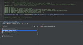

SIGTRAP on sd_softdevice_enable
I'm compiling a custom application using the CMake scripts in the nRF mesh SDK. The first time I flash to the nRF52832 a SIGTRAP occurs on sd_softdevice_enable. I cannot continue from this. If I flash again, it does not occur. Any idea what might be happening, or how I can prevent this?
See also related issue https://devzone.nordicsemi.com/f/nordic-q-a/50709/breakpoints-not-being-hit
I'm wondering if when this SIGTRAP occurs, it is because the softdevice is missing, but breakpoints work because the breakpoint address is being set relative to flash start. When the softdevice is present the SIGTRAP does not occur but breakpoints do not work because they are still relative to flash start not to application start, so land somewhere in the softdevice.
So if I'm correct, that leads to two questions: Why is the softdevice not being written on first flash, and how do I offset breakpoints by the softdevice length?
    The Softdevice must be programmed at least partially for the program execution to reach the main app. I remember seeing similar issues before with Segger embedded Studio where a fault exception gets triggered on sd_ enable, but then it has been related to debugger configuration. Maybe you can try to just reset the device instead of flashing it again, then read out the CPU registers to see if the fault also gets triggered when you're not debugging with GDB.
    The "nrfjprog --readregs" command will read out the CPU registers where the last byte of xPSR will tell you the current interrupt number (=3 if hardfault =0 if none).

    Does this mean the hardfault is not occurring when running without the debugger?
  • I haven't had this problem with GDB. Are there some GDB scripts included in the Mesh SDK?

  • Ah, turns out the default in CLion 2019.2 uses JLinkGDBServer to download the firmware image when changes are made, and it seems to set the PC register after doing that:

    So now after disabling that (because I'm using the CMake flash_ target to write the firmware) it doesn't happen. However, breakpoints I set are not being hit:

    Here a breakpoint is set at a point before a SIGTRAP occurs, but it is not hit. Do you have any suggestions?
  • Perhaps it is because JLinkGDBServer is not actually resetting the target so the SIGTRAP has already occurred...And breakpoints do work when JLinkGDBServer downloads the firmware image, until the SIGTRAP in the softdevice enable. So if correct, either I need to make JLinkGDBServer reset the target or I use JLinkGDBServer to download the image but somehow prevent it setting the PC register...
  • Yes I think this is the reason. If I run "mon reset" in gdb and then continue, I hit the breakpoint. Can I get JLinkGDBServer to do this when running?
  • Maybe you can try to append --noir ("Do not initialize the CPU registers on startup.") to the list of GDB server argument to see if that helps.
