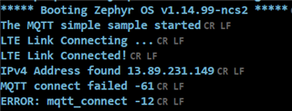

So I'm trying to modify the mqtt_simple sample program to connect to azure iot
I've modified the code in a few ways but when I went to run the program it gave me this error
Which from my understanding is a failure to connect w/ the mqtt client
and the mqtt_connect error comes from the mqtt.h/c file which is an error of  ENOMEM (err no memory??) in the tx_buf or the rx_buf
So I manually changed the buffer size in the config file

And once I try to build it, it gives me an out of tree board error
My main question is, would I be able to resolve the -12 mqtt_connect error by adjusting the buffer size? And if so, how would I go about doing that if not in the proj.conf file.
Any help is appreciated, thank you
Octavio
EDIT: I should add, I tried running SES as administrator and that didn't seem to help.
    There is some syntax error in your config file, you should remove the space around the = sign, i.e. so it looks like this instead:
    CONFIG_MQTT_MESSAGE_BUFFER_SIZE=128
    CONFIG_MQTT_PAYLOAD_BUFFER_SIZE=128
    It's worth trying, but if you are hitting the ENOMEM shown in the screenshot you attached, then it seems like you are getting the ENOMEM because the buffers are NULL.
    Did you call client_init() before calling mqtt_connect() ?

  • Hi Sigurd,
    Okay, so I've got my current problems narrowed down to the poll function in main.
    When it returns my fds.revents has a value of 0x10 which apparently means that the poll detected a closed connection?
    How would I go about enabling the socket for readability, or I guess how would I proceed from here?

  • Hi again Sigurd,
    So I think I've got this somewhat sorted out, I added a provision_certificates function, added the baltime root certificate that comes w/ the Azure SDK to certificates.h, and was able to configure the prj file. After some debugging of all that, I'm now stuck on this issue:
    once I get into the actual loop, my event handler comes back w/ a result of 5 and fails to connect.
    Any help is appreciated, Thank you
  • What function is returning 5? mqtt_connect() ?
  • mqtt_input in the loop, it calls upon several functions which eventually call the event handler.
    As you can see the switch statement for the event handler returns "MQTT connect failed: %d" with the result value as the return value
  • How does your main.c look like now ?

    	printk("The MQTT simple sample started\n");
    	err = mqtt_provision();
    	if (err != 0) {
    		printk("ERROR: mqtt_provision %d\n", err);
    		return;
    	modem_configure();
    	client_init(&client);
    	err = mqtt_connect(&client);
    	if (err != 0) {
    		printk("ERROR: mqtt_connect %d\n", err);
    		return;

    #if defined(CONFIG_LTE_LINK_CONTROL)
    	if (IS_ENABLED(CONFIG_LTE_AUTO_INIT_AND_CONNECT)) {
    		/* Do nothing, modem is already turned on
    		 * and connected.
    	} else {
    		int err;
    		printk("LTE Link Connecting ...\n");
    		err = lte_lc_init_and_connect();
    		__ASSERT(err == 0, "LTE link could not be established.");
    		printk("LTE Link Connected!\n");
    /* Provisions root CA certificate using nrf_inbuilt_key API */
    static int mqtt_provision(void)
    #if defined(CONFIG_MQTT_LIB_TLS)
    	static sec_tag_t sec_tag_list[] = {CONFIG_MQTT_SEC_TAG};
    	tls_config.peer_verify = 2;
    	tls_config.cipher_count = 0;
    	tls_config.cipher_list = NULL;
    	tls_config.sec_tag_count = ARRAY_SIZE(sec_tag_list);
    	tls_config.sec_tag_list = sec_tag_list;
    	tls_config.hostname = CONFIG_MQTT_BROKER_HOSTNAME;
    #if defined(CONFIG_MQTT_PROVISION_CERTIFICATES)
    #if defined(CONFIG_BSD_LIBRARY)
    		int err;
    		/* Delete certificates */
    		nrf_sec_tag_t sec_tag = CONFIG_MQTT_SEC_TAG;
    		for (nrf_key_mgnt_cred_type_t type = 0; type < 5; type++) {
    			err = nrf_inbuilt_key_delete(sec_tag, type);
    			printk("nrf_inbuilt_key_delete(%lu, %d) => result=%d\n",
    				sec_tag, type, err);
    		/* Provision CA Certificate. */
    		err = nrf_inbuilt_key_write(CONFIG_MQTT_SEC_TAG,
    					NRF_KEY_MGMT_CRED_TYPE_CA_CHAIN,
    					MQTT_CA_CERTIFICATE,
    					strlen(MQTT_CA_CERTIFICATE));
    		if (err) {
    			printk("MQTT_CA_CERTIFICATE err: %d\n", err);
    			return err;
    		/* Provision Private Certificate. */
    			NRF_KEY_MGMT_CRED_TYPE_PRIVATE_CERT,
    			MQTT_CLIENT_PRIVATE_KEY,
    			strlen(MQTT_CLIENT_PRIVATE_KEY));
    		if (err) {
    			printk("MQTT_CLIENT_PRIVATE_KEY err: %d\n", err);
    			return err;
    		/* Provision Public Certificate. */
    			NRF_KEY_MGMT_CRED_TYPE_PUBLIC_CERT,
    			MQTT_CLIENT_PUBLIC_CERTIFICATE,
    			strlen(MQTT_CLIENT_PUBLIC_CERTIFICATE));
    		if (err) {
    			printk("MQTT_CLIENT_PUBLIC_CERTIFICATE err: %d\n",
    				err);
    			return err;
    #else
    		int err;
    		err = tls_credential_add(CONFIG_MQTT_SEC_TAG,
    			TLS_CREDENTIAL_CA_CERTIFICATE,
    			sizeof(MQTT_CA_CERTIFICATE));
    		if (err < 0) {
    			printk("Failed to register ca certificate: %d\n",
    				err);
    			return err;
    			TLS_CREDENTIAL_PRIVATE_KEY,
    			sizeof(MQTT_CLIENT_PRIVATE_KEY));
    		if (err < 0) {
    			printk("Failed to register private key: %d\n",
    				err);
    			return err;
    			TLS_CREDENTIAL_SERVER_CERTIFICATE,
    			sizeof(MQTT_CLIENT_PUBLIC_CERTIFICATE));
    		if (err < 0) {
    			printk("Failed to register public certificate: %d\n",
    				err);
    			return err;
    #endif /* defined(CONFIG_BSD_LIBRARY) */
    #endif /* defined(CONFIG_MQTT_PROVISION_CERTIFICATES) */
    	return 0;
    void main(void)
    	int err;
    	if (err != 0) {
    		return;
    	modem_configure();
    	if (err != 0) {
    		return;
    	err = fds_init(&client);
    	if (err != 0) {
    		printk("ERROR: fds_init %d\n", err);
    		return;
    	while (1) {
    		err = poll(&fds, 1, K_SECONDS(CONFIG_MQTT_KEEPALIVE));
    		if (err < 0) {
    			printk("ERROR: poll %d\n", errno);
    		err = mqtt_live(&client);
    		if (err != 0) {
    			printk("ERROR: mqtt_live %d\n", err);
    		if ((fds.revents & POLLIN) == POLLIN) {
    			err = mqtt_input(&client);
    			if (err != 0) {
    				printk("ERROR: mqtt_input %d\n", err);
    		if ((fds.revents & POLLERR) == POLLERR) {
    			printk("POLLERR\n");
    		if ((fds.revents & POLLNVAL) == POLLNVAL) {
    			printk("POLLNVAL\n");
    	printk("Disconnecting MQTT client...\n");
    	err = mqtt_disconnect(&client);
    	if (err) {
    		printk("Could not disconnect MQTT client. Error: %d\n", err);

  • let me edit my files to remove any sensitive information and i'll post it
  • Hi Sigurd,
    I finally got around to editing my files, I'll upload them here. Thanks in advance

    void main(void)
    	int err;
    	provision_certificates();
    	modem_configure();
    	if (err != 0) {
    		return;
    	if (err != 0) {
    		return;
    	printk("NOW ENTERING ENDLESS POLLING LOOP\n");
    	while (1) {
    		if (err < 0) {
    		if (err != 0) {
    			if (err != 0) {
    	if (err) {
    		       err);
    # General config
    CONFIG_TEST_RANDOM_GENERATOR=y
    # Networking
    CONFIG_NETWORKING=y
    CONFIG_NET_SOCKETS_OFFLOAD=y
    CONFIG_NET_SOCKETS=y
    CONFIG_NET_SOCKETS_POSIX_NAMES=y
    CONFIG_NET_SOCKETS_SOCKOPT_TLS=y
    # LTE link control
    CONFIG_LTE_LINK_CONTROL=y
    CONFIG_LTE_AUTO_INIT_AND_CONNECT=n
    # BSD library
    CONFIG_BSD_LIBRARY=y
    # AT Host
    CONFIG_AT_HOST_LIBRARY=y
    # MQTT
    CONFIG_MQTT_LIB_TLS=y
    CONFIG_MQTT_LIB=y
    #added config stuff
    CONFIG_SEC_TAG=16842753
    CONFIG_PROVISION_CERTIFICATES=y
    CONFIG_CERTIFICATES_FILE="certificates.h"
    CONFIG_NO_OPTIMIZATIONS=y
    # Application
    CONFIG_MQTT_PUB_TOPIC="publish"
    CONFIG_MQTT_SUB_TOPIC="subscribe"
    CONFIG_MQTT_CLIENT_ID="MyCDevice"
    #CONFIG_MQTT_BROKER_HOSTNAME="postman.cloudmqtt.com"
    #CONFIG_MQTT_BROKER_PORT=11105
    CONFIG_MQTT_BROKER_HOSTNAME="azureiothubhostname"
    CONFIG_MQTT_BROKER_PORT=8883
    # Main thread
    CONFIG_MAIN_THREAD_PRIORITY=7
    CONFIG_MAIN_STACK_SIZE=4096
    CONFIG_HEAP_MEM_POOL_SIZE=1024
    # Disable native network stack to save some memory
    CONFIG_NET_IPV4=n
    CONFIG_NET_IPV6=n
    CONFIG_NET_UDP=n
    CONFIG_NET_TCP=n
    #added Configuring of buffer sizes?
    CONFIG_MQTT_MESSAGE_BUFFER_SIZE=512
    CONFIG_MQTT_PAYLOAD_BUFFER_SIZE=512
  • Hi sigurd, I was wondering if you had any insight into my problem. Thanks
    Yes, the error 5 is MQTT_NOT_AUTHORIZED.
    I did some tests here with my own Azure IoT HUB account, and I got this error if either the SAS token was wrong/invalid/expired, or the device name was wrong.
