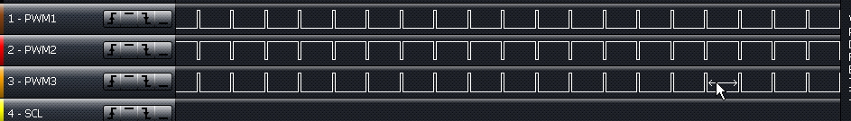

PWM signal was reversed.
I using github code. SDK is 7.0.1 SD : S110 7.1.0
Channel : 4 ch
Period : 20ms
Width : 1-2ms ( RC )
Sometimes the width operates at 18-19ms.
ex : PWM2 was reversed. image description

  • Hi
    The latest revision of the nRF51x22 has a issue that affects PWM if you use powerdown, and it might be this issue causing the PWM inverting.
    Fortunately a workaround exists, and I will try to update the PWM driver today to implement it.
    Can you confirm if you are using power down, and also what revision of the nRF51x22 you have?
    UPDATE: Sorry for the slow response, I was caught up in other things. Can you please try the attached file and see if it works better? nrf_pwm.c
    It now adds the workaround for the timer issue introduced in revision 3 (and explained in the nRF51x22 PAN).
    If you can confirm that it solves the issue I will also push an update to the repository.
    Regards Torbjørn

  • Hi, Torbjørn, What do you mean exactly by powerdown? If I do this: sd_power_mode_set(NRF_POWER_MODE_CONSTLAT); does this avoid any PWM powerdown issue? I'm using USE_WITH_SOFTDEVICE = 1 and I have 3 PWM channels.
    Even with this, and with the Feb 5 2015 Github release of nrf_pwm.c, I still sometimes get an inverted waveform (I'm only looking at channel 0 for now).
    I repeat this sequence 10 times a second (with PWM frequency = 488 Hz):
    • set pwm value to 0 (to float one side of an H-bridge) for 5ms
    • read two ADC channels
    • restore PWM value to previous setting
    • do some calculations (quickly)
    • set new PWM value
    I'm suspecting there is a problem with your code when it writes to TASKS_OUT to "fix" the polarity of the output. I think sometimes it gets it wrong, and inverts the waveform by mistake.
    It looks to me like there is a race condition between when the CC[2] is captured and when the TASKS_OUT is written, though I think the safe_margins_present() is supposed to prevent that. I tried increasing the pwm_cc_margin_by_prescaler[] for my prescaler, but this did not help.
