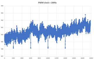

    Sorry for a late reply, we were waiting for the Logic Analyzer to arrive. I finally recorded the PWM signal sequences and here is what we get:
    I was recording our PWM signal for about 20 seconds. Our PWM clock (.base_clock) was set to 1MHz. We drive the buzzer with the 988Hz frequency (1.012ms period) so we get about 20K PWM sequencies. For each sequence, we measure and display frequency of the PWM driver signal. SoftDevice is present in our code but we stoped BLE advertising during the moments we drive the buzzer with PWM driver. Here are the results:
     What I can say is that there is no PWM glitch but that the frequencies/periods of PWM signal varies from sample to sample (in a range from desired 988Hz to almost 993Hz). There are also moments in time when the frequencies dip down and this is probably when we can feel the wobbling of the sound.

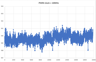

    We tried to use 16MHz clock for our PWM driver and this is what we get:
    Variations between the frequencies are less pronounced but the wobbling of the sound still remains.
    The main question here is: if we set the period of the PWM signal to 1.012ms/988Hz with
    .top_value    = 1000000 / frequency, // default frequency = 988Hz
    for 1MHz PWM clock or with
    .top_value    = 16000000 / frequency, // default frequency = 988Hz
    for 16MHz PWM clock, why the frequencies of  PWM signal slightly vary from sample to sample? Is there any internal conflict inside nRF52840 SoC?

    The variation that you're experiencing isn't really that much and is within what we would expect of the PWM peripheral. The variation is due to the inaccuracy of the HFXO. I'm not really sure if the woobling is due to the small drops in frequency because i've seen several applications that has used the PWM peripheral with a buzzer without the woobling sound. Are you able to drive the buzzer directly from the development kit and see if the issue persists?
    Jared
