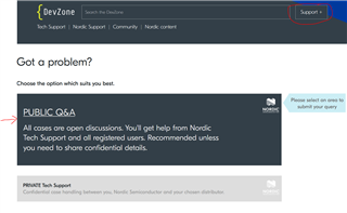

  • Hi Shemin,
    Please open a new ticket in Devzone if you need help with this. This thread is 2 years old. Click on the 'Support+' ticket on the right side of the search bar and then click to open a new public Q&A ticket.
    Marjeris
