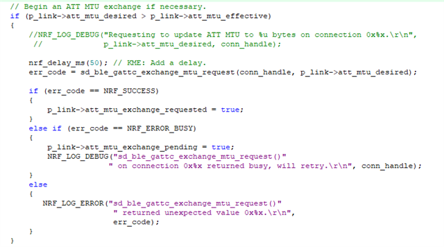

  • Can you try to add the delay in nrf_ble_gatt.c go on_connected_evt() as suggested here:
    Kenneth
  • Hi Kenneth
    If I add delay, Is it anything wrong with the performance?
    If there is no problem, do I have to have some delay?
    thank!
  • I asked you to do a test by adding one line of code and you have not done so? During debugging we rely on you to test code to narrow down the root cause.
    What SDK and SD are you using?
    Does it happens every time with nexus 6? Or does it happen only sometimes?

  • It is difficult to know exactly what is failing here, there is no specific violation in the log that I can find. In the past I have seen some of the old phones do not gracefully handle if there is data length exchange initiated directly upon connection, so that is why I wanted you to try the delay to check if that is the cause.
    Alternatively you may also want to try to check if you are somewhere calling pm_handler_secure_on_connection() and change that to pm_handler_secure_on_error() instead. What is the purpose of this change? Don't trigger security procedure upon connection, but only if security fails. This will follow apple guidelines that security should be initiated by the phone.
    I believe the only way to root cause this is for you to try with the specific phone again and check if any of the above remove the failure situation.
    Kenneth

  • It is difficult to know if the same solution for both cases. Have you tried my suggestions?
    - add delay
    - use pm_handler_secure_on_error() instead
    Does the problem still occur?
    Kenneth
