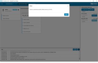

after bonding, when try reconnect, Failed to authenticate happen. how can I fix?
I try to bonding.
Using SDK 15.3. 0 and S332 Softdevice.
I successed bonding procedure used Peer manager.
after bonding, If I try to connect one more, nRF Connect app show Failed to authenticate (NRF_ERROR_INVALID_STATE).
however connection is still working.
