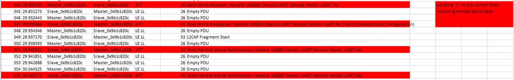

ble_nus_c_string_send leads to BLE_GAP_EVT_DISCONNECTED instead of BLE_GATTC_EVT_HVX event
I'm currently using the nRF52840 DK and i need some help.
On the other hand, i have BLE ela identifiers/sensors : elainnovation.com/bluetooth-low-energy.html
My code is already handling nRF52840 DK (the client) and  BLE ela Sensor (the server) connection AND NUS discovering as you can see below

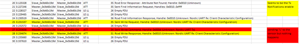

Now i need to write the command "L" in the Rx client characteristic to receive data (temperature for example) from the BLE sensor.
The problem is, whatever i'm sending with ble_nus_c_string_send function, it leads to a BLE_GAP_EVT_DISCONNECTED whereas I should get data thanks to BLE_GATTC_EVT_HVX events and on_hvx() function.
I've already tried to get temp data with nrf toolbox and UART tool and it works perfectly just by connecting to the sensor and sending L when I enable notifications by setting TX BLE sensor characteristic.
If I do not set TX BLE sensor characteristic via UART tool, it also leads to a disconnection. So i though that was the problem in my code too but i'm using ble_nus_c_tx_notif_enable() so the BLE server should be able to receive RX commands when i'm using ble_nus_c_string_send() function.
