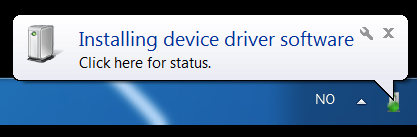

    I have found that when installing a newer version of the J-Link drivers, Windows 7 needs to install drivers again when I connect boards that are previously used with the same computer. Did you get any indication of such activity, and/or any message such driver installation failed?

    5. Right-clicked on the failed load in the device manager and tried to update the driver.  I pointed it to the JLink 6.34b\USBDriver folder and it seemed to recognize that it is a valid driver (which is new—before this system restore, pointing it at 6.44e didn’t work, but this earlier system restore left me with more JLink drivers to choose from, so I picked the next older one that I had before 6.44: 6.34b).  But updating it didn’t cause it to load correctly
    6. Right-clicked on the failed load in the device manager and Uninstalled the driver (while keeping the device plugged in and turned on).  I also told Windows to “remove the files” after it uninstalled. It uninstalled, then immediately self-installed the 6.34 version of the driver
    7. It worked for a few minutes…I was able to enumerate and see all the components of the driver for all of the boards, and I was able to use Nordic’s command line tools to connect through the segger-ob processor to halt, run, and reset the board
    8. Then the driver hung the machine on an enumeration, again…kinda like what seemed to happen the first time.
