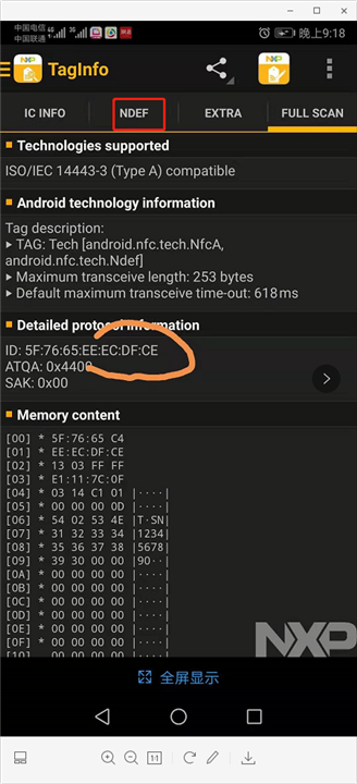

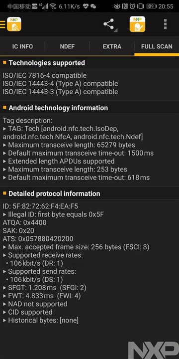

2. All memory section is readable(full scanned) and writable by proper reader device.
I tested two example in SDK15.3, record_text and writable_ndef_msg , it turns out that all memory content of record_text can be scanned ,  but I cannot see any memory content of writable_ndef_msg ? could anyone tell me how to do full scan of writable_ndef_msg ?
