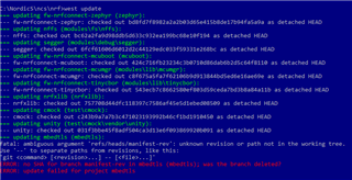

Why do I get the folowing error with mbedtls when doing "west update"?
Possibly related issues:

This could be related to this issue.
Try to run this to update to the newest west version (0.6.2) and then try west update again.
pip3 install west --upgrade
If that for some reason fails, try
pip3 install west==0.6.0 --upgrade
Yes. Indeed west was having trouble with mbedtls due to a developer error.
Updating west and and its dependencies fixed the error.
The easiest way to overcome the 2nd problem (above) is to make a git checkout and force it to remove any old stuff.
cd ${NORDICS}/ncs/nrf
git checkout -f master
git pull
git checkout v1.0.0
west update
