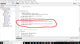

  2. During the initialization part(saadc_init) "nrf_drv_saadc_buffer_convert" function is calling and also inside the  "saadc_callback" function   is "nrf_drv_saadc_buffer_convert" function is calling . I known these function is for  issuing conversion of data to buffer. Then why its calling on both "saadc_init"  and  "saadc_callback" function.
    This will set the DMA pointer, as shown in the description of the function call in nrfx_saadc.h:
     * @brief Function for issuing conversion of data to the buffer.
     * This function is non-blocking. The application is notified about filling the buffer by the event
     * handler. Conversion will be done on all enabled channels. If the ADC is in idle state, the
     * function will set up Easy DMA for the conversion. The ADC will be ready for sampling and wait for
     * the SAMPLE task. It can be triggered manually by the @ref nrfx_saadc_sample function or by PPI
     * using the @ref NRF_SAADC_TASK_SAMPLE task. If one buffer is already set and the conversion is
     * ongoing, calling this function will result in queuing the given buffer. The driver will start
     * filling the issued buffer when the first one is completed. If the function is called again before
     * the first buffer is filled or calibration is in progress, it will return with error.
     * @param[in] buffer Result buffer.
     * @param[in] size   Buffer size in words.
     * @retval NRFX_SUCCESS    If conversion was successful.
     * @retval NRFX_ERROR_BUSY If the driver already has two buffers set or calibration is in progress.
    nrfx_err_t nrfx_saadc_buffer_convert(nrf_saadc_value_t * buffer, uint16_t size);
    From which buffer we can read the converted analog to digital data ?
     That would be the buffer you provide it via nrf_drv_saadc_buffer_convert().

          2. I need some clarification here in Nordic saadc example  during the initialization part i e  "saadc_init " function  they assigning some buffer "m_buffer_pool[0] and m_buffer_pool[1]" and also in the "saadc_callback" function they are doing the same but different buffer "p_event->data.done.p_buffer" and they using this value as adc result too.  Suppose if we take ""m_buffer_pool[0] " or""m_buffer_pool[1] " as adc result what will happen, Is it the same value in the "p_event->data.done.p_buffer" ?
    Yes, p_event->data.done.p_buffer will point to the m_buffer_pool array. You can enter debug mode, and look at the pointers, and the global arrays, to see if they match in address to verify this.

    1. why Nordic using 2D array as buffer instead of normal array .                                                                   "static nrf_saadc_value_t     m_buffer_pool[2][SAMPLES_IN_BUFFER];"
    2. why Nordic assigning the buffer 2 times in  "saadc_init " function ? Is the first time assigning is enough?
  • The saadc driver has support for handling two buffers.
    The _END event will then alternate between m_buffer_pool[0] and m_buffer_pool[1]. You can look at this by entering debug mode and placing a breakpoint in that callback.
